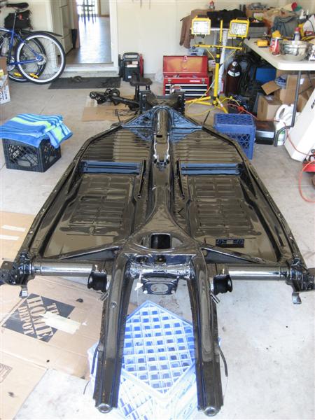

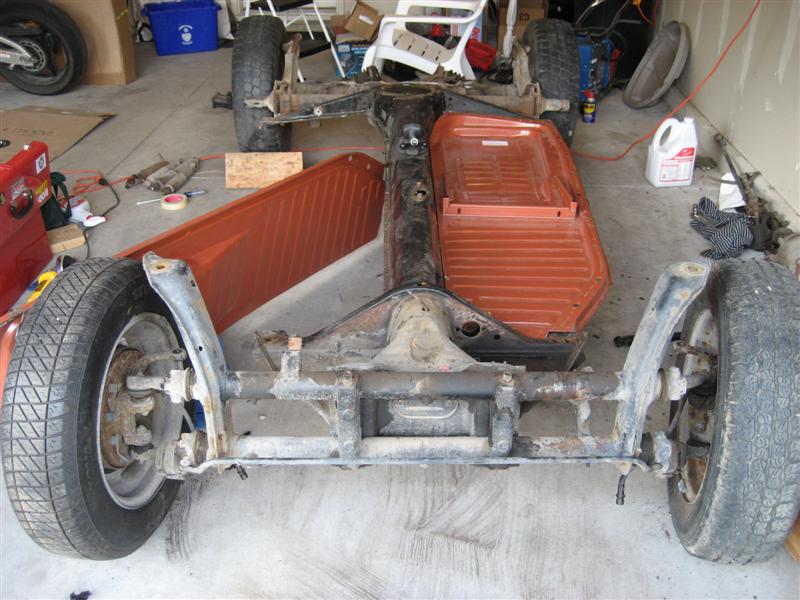

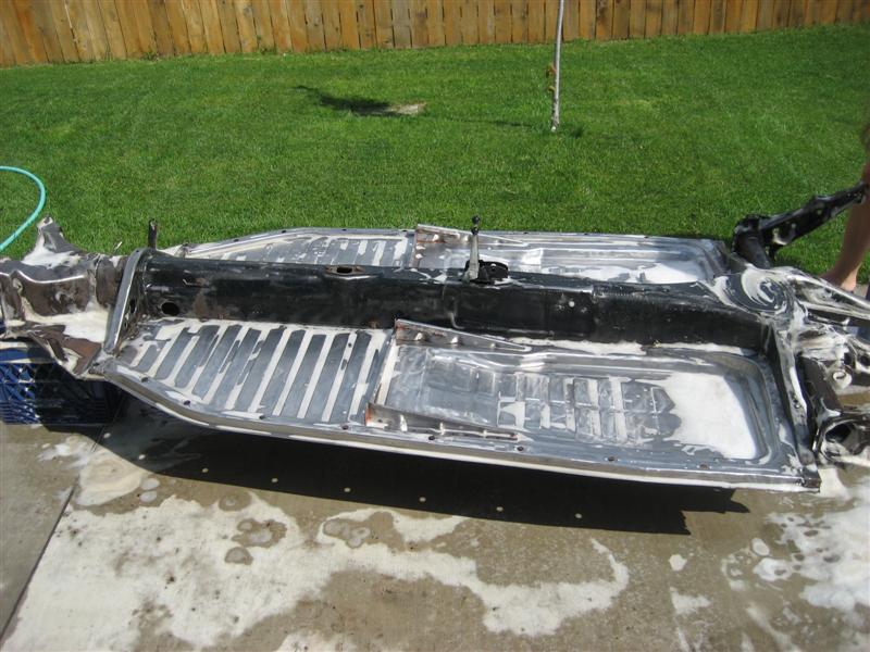

Thought I'd post some pics of the pan rebuild, last coat of paint went on this weekend. New floorpans were welded on, por-15 applied, seam sealer, etc.

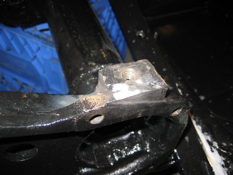

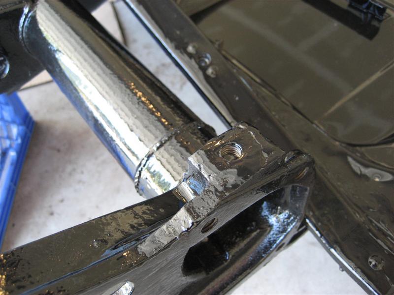

Had a broken bolt in one of the shock towers at the back, and my extractor tool broke inside it while i was trying to pull it out. Had to drill around it (cant' drill through the hardened steel of the extractor tool), and pull the whole bit out. The hole left was pretty big, but just the right size for a flared 10mm nut, which I pressed in there, then welded around into the cast iron surrounds. Came out pretty well, considering.

the 10mm nut welded into the rear shock tower, and cleaned up.

new pans welded in, stripped of paint, and getting por-15 metal ready on them.

chassis with the old pans cut out, and new ones trial fitted.

more pics
pan painted, and ready to start receiving the suspension parts

shock tower after painting
