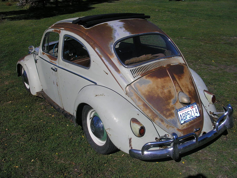

Hey Eric....that bug is sittin' real nice! Low...but not too low! Did you end up doing a 4 inch narrow on the beam, or 2? I'm starting to think I should of took my time, and done a narrow on the beam when I did the adjusters. This has just the right "tuck"....I'm digging it!!
PostPosted: Mon Sep 27, 2010 9:39 am    Post subject: Reply with quote
Just a 2" total narrowed beam, done off a '65 king/link. I cut 4" out of the center, adjusters are 2" wide. I think 2" is plenty for stock wheels, the rear is too low though, with a deep sump, not much room under there.
PostPosted: Tue Sep 28, 2010 7:30 am    Post subject: Reply with quote
Go cal-stance with rat looks.... Question i.e. stock rear height.
I like it.
PostPosted: Tue Sep 28, 2010 8:57 pm    Post subject: Reply with quote
Those rear tires look pretty wide Eric, is that why it's rubbing? I was thinking 1 1/2 clicks on the rear with 165's for mine. I remember when you showed me those wheels...aren't they 50 series tires or something?
PostPosted: Wed Sep 29, 2010 10:31 am    Post subject: Reply with quote
They are 205-60-15's in the rear, rubbing is gone after a little work. It's still too low, going to come up an 1" or so.
