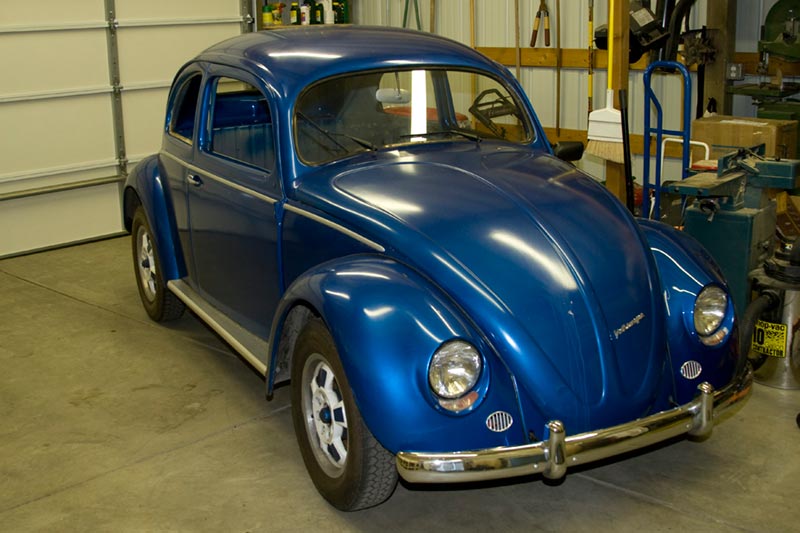

'56 Custom Project
This is a body that I rescued from a now closed wrecking yard in Seattle back in 1992. It was hit so hard in the passenger rear quarter that the car was rolled up on the driver side and the rain gutter was crushed.
 Filesize:  70.81 KB
 Viewed:  21354 Time(s)
There's a ton of filler in that quarter!

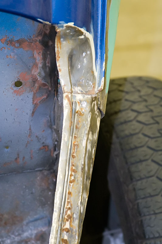

'56 Custom Project

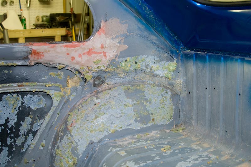

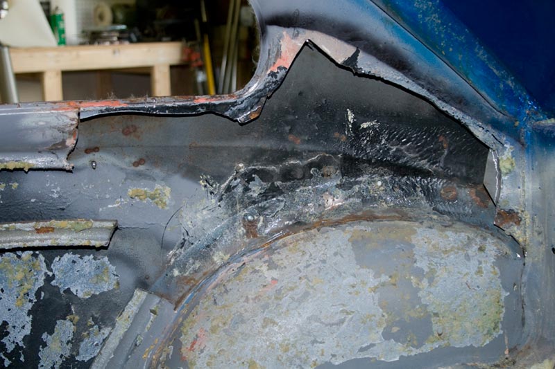

First thing to do is fix the inside of the quarter. This was some sloppy work, but what do you expect from an 18 year old?
 Filesize:  75.37 KB
 Viewed:  21352 Time(s)
Here you see the old metal all cut out.
 Filesize:  83.82 KB

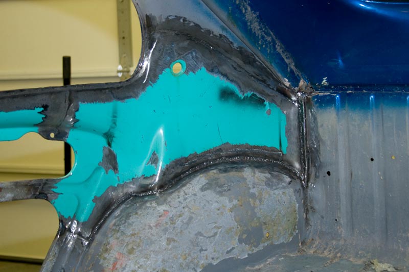

The new piece is all welded in!
 Filesize:  57.55 KB

'56 Custom Project

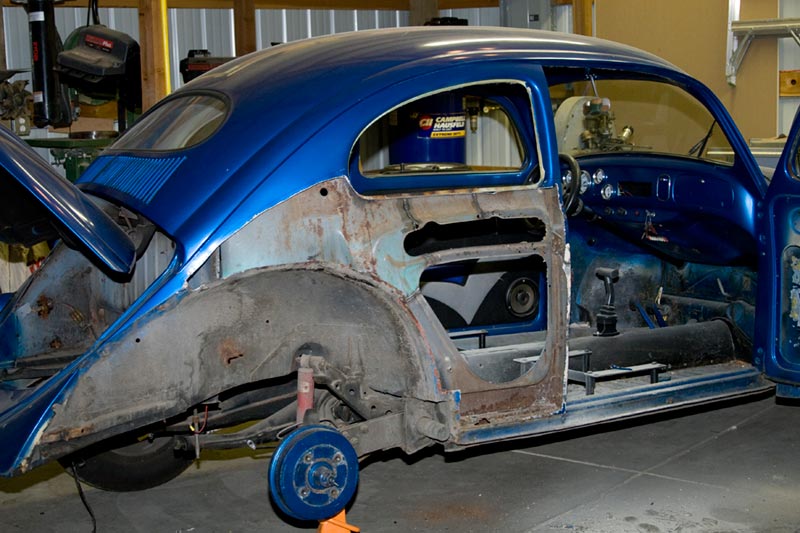

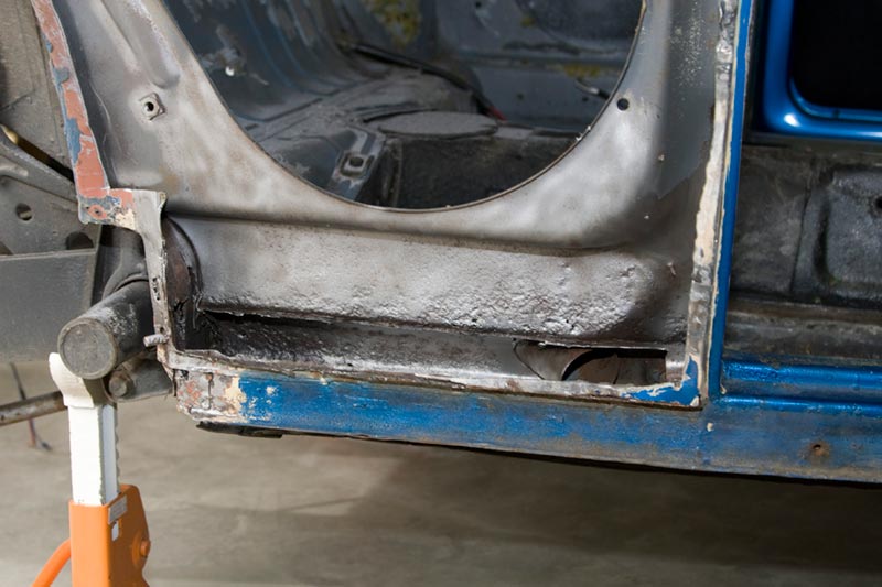

I got the quarter cut out and found a bunch of rust behind it. The car sat with no windows in the wrecking yard for a few years.
 Filesize:  84.87 KB
 Viewed:  21351 Time(s)
The majority of the rust has all be blasted away. It's gonna take some work to replace the soft metal though.
 Filesize:  64.46 KB

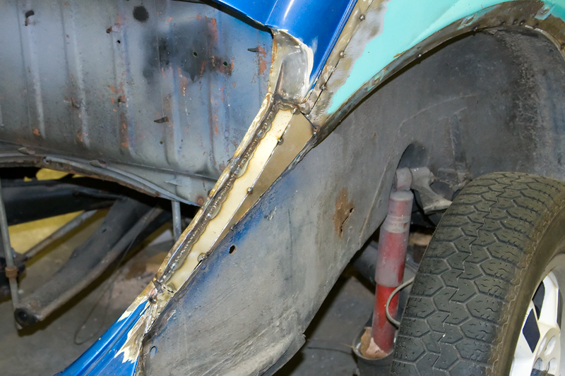

The outside portion of the heater channel is finished. I still need to do some work from the back. But I have to pull the body off the pan for that.
 Filesize:  64.42 KB

'56 Custom Project

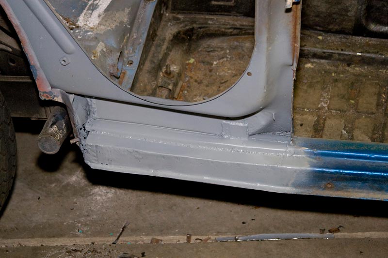

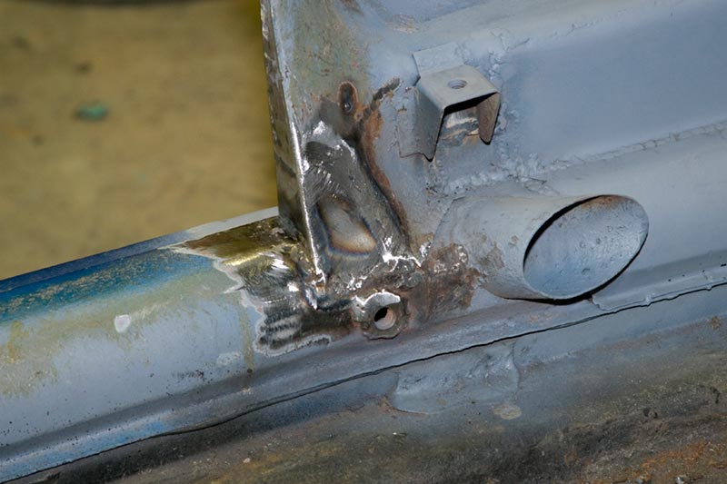

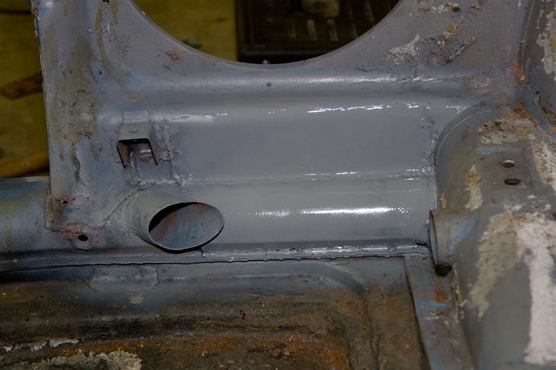

The inside is almost finished. You can see a few pin holes in the bottom of the B-post that still need some work.
 Filesize:  54.98 KB
 Viewed:  21350 Time(s)
The top side of the passenger heater channel is all finished.
 Filesize:  59.52 KB

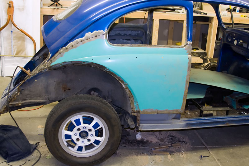

'56 Custom Project - Finally back at it!
As you can see, the new quarter skin has been cut and tacked in place.
 Filesize:  102.68 KB
 Viewed:  19571 Time(s)
There is still some work to do on the back edge where the deck lid meets the fender. After that is cut and tacked in, I need to get a piece for the bottom of the quarter and rebuild the door jam.
 Filesize:  72.96 KB

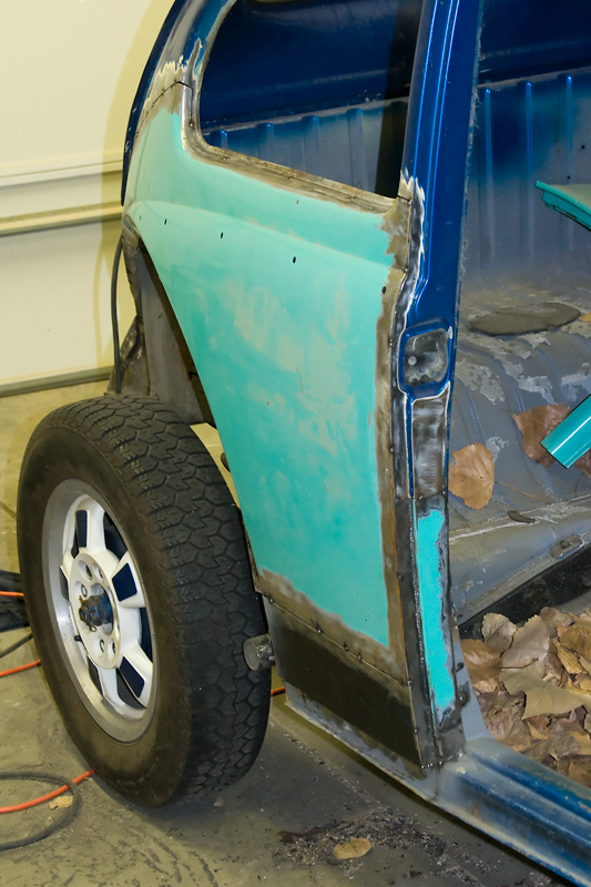

'56 Custom Project
The entire quarter has now been replaced and everything is tacked in. All that's left is final welding and a ton of grinding.
 Filesize:  229.41 KB
 Viewed:  19513 Time(s)
The top edge of the quarter has been rebuilt. Everything is tacked into place and will be welded soon.
 Filesize:  237.3 KB
