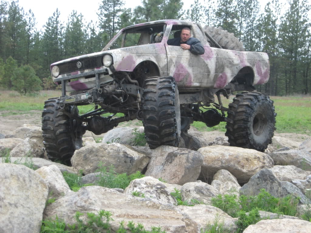

Here is my '81 Caddy.

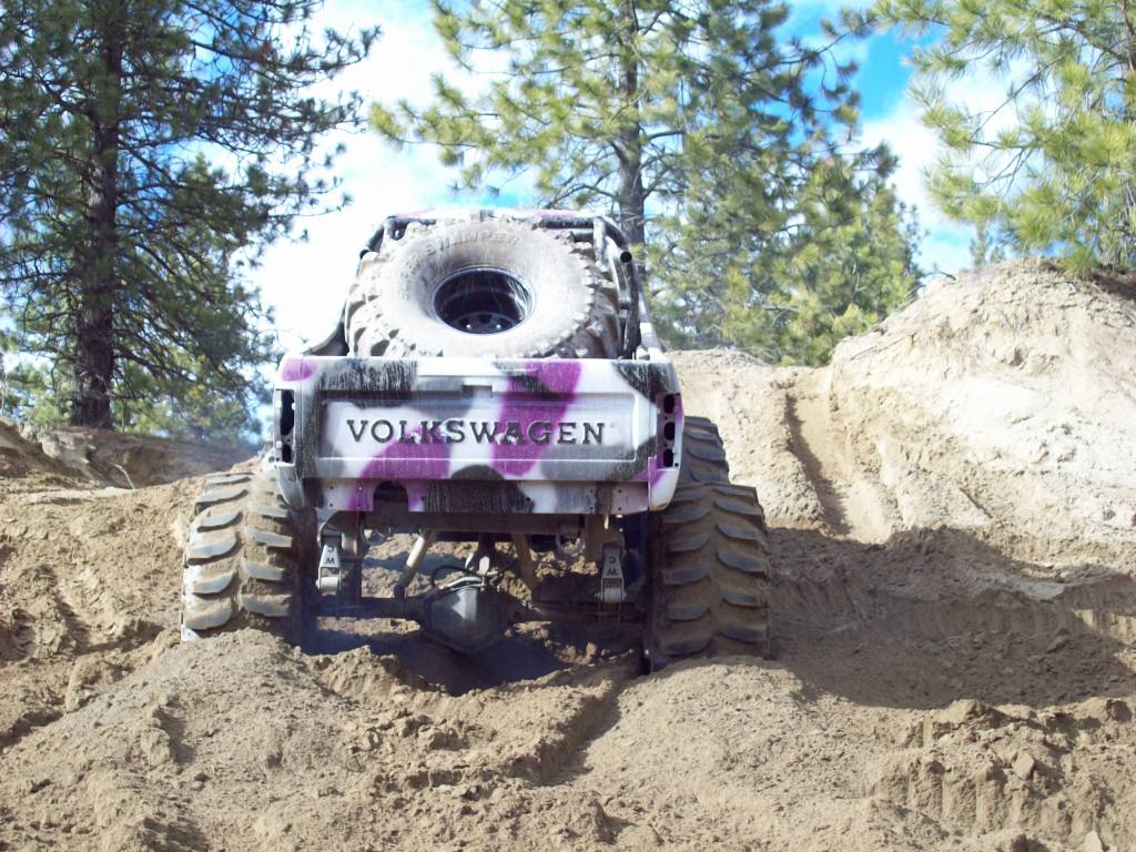

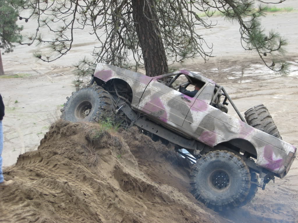

Here's a few more from the last time out.

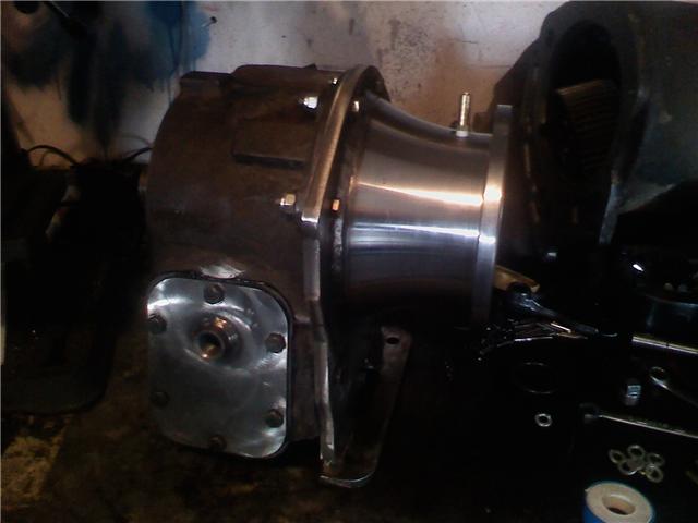

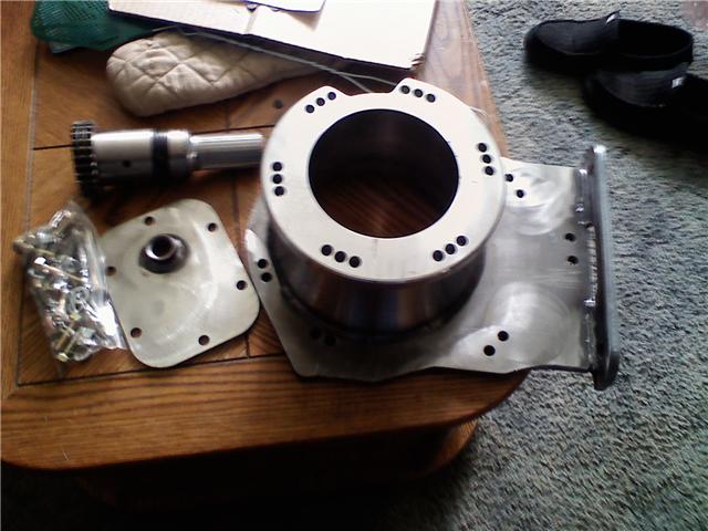

I got my double transfer case adapter today, started assembling it already. I'm doing a 203/205 doubler, in double low range it is 3.96:1 instead of just 2:1 low. Gonna do some serious crawling now!

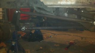

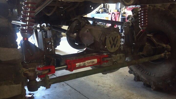

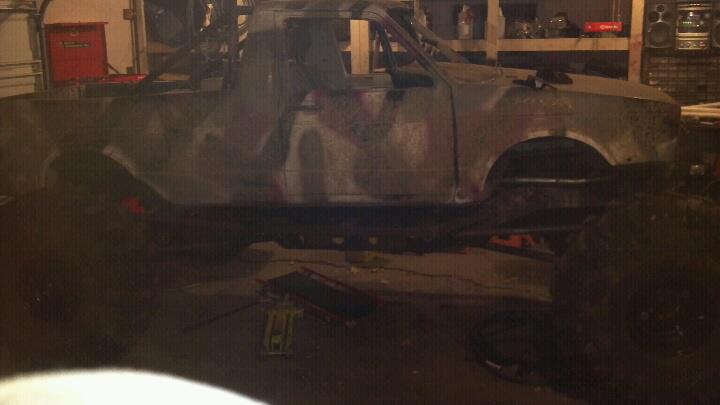

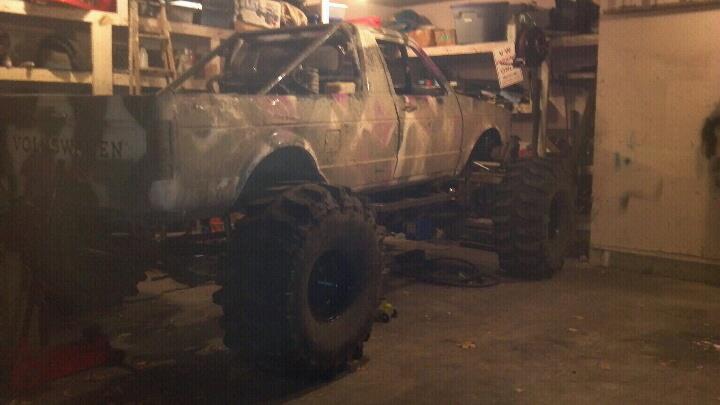

Long time no see guys. I got the dual cases done, took the rig out twice, and exploded the one ton axles. Now it's sitting on 2 1/2 ton Rockwell military axles, held in by triangulated four links. It has four wheel steering now also. I'm hoping to have it done by the end of summer. Here is a couple shots of it now.

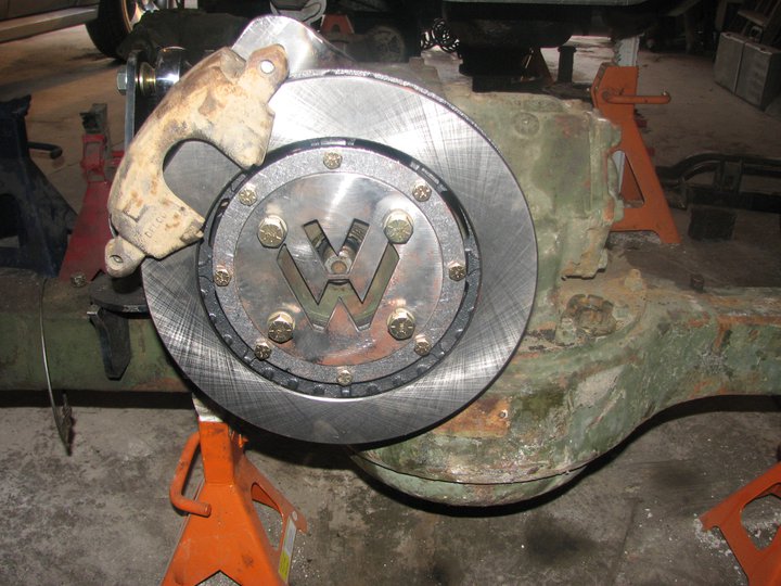

Here is a shot of the pinion brakes I had made for it.
 Filesize:  91.59 KB
 Viewed:  27799 Time(s)
If it can't be done, I can prove them wrong!
PostPosted: Wed Feb 01, 2012 9:09 pm    Post subject: Reply with quote
So you have brakes only on the drive shaft?

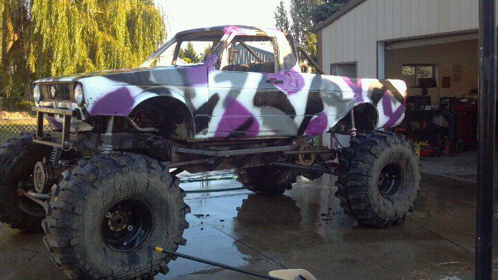

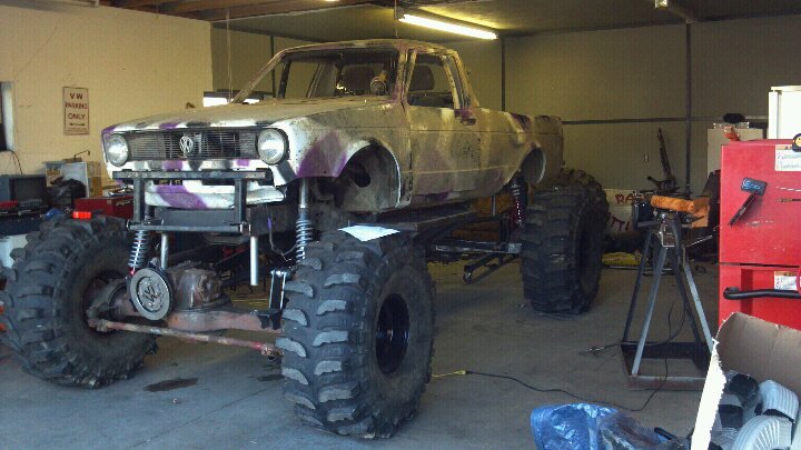

Yes it's on Rockwell 2 1/2 ton military axles. I am entering it in next year's Four Wheeler magazine's Top Truck Challenge. I need the votes to get in! I will be the first to compete in a VW if I make it in, so show a guy some love and send in some votes, please! Here's how it looks now, almost done.

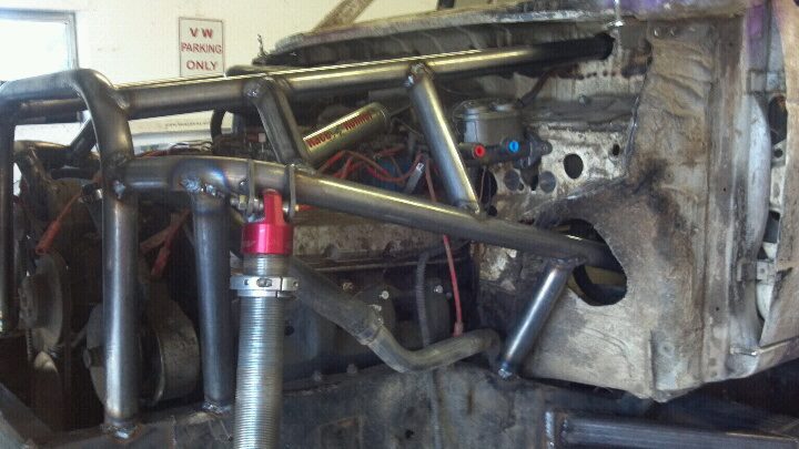

PostPosted: Mon Oct 29, 2012 8:31 pm    Post subject: Reply with quote

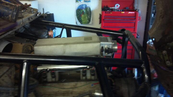

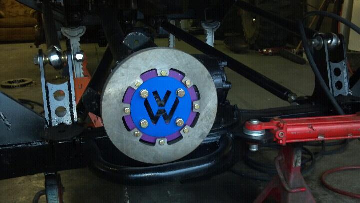

Updated build shots.

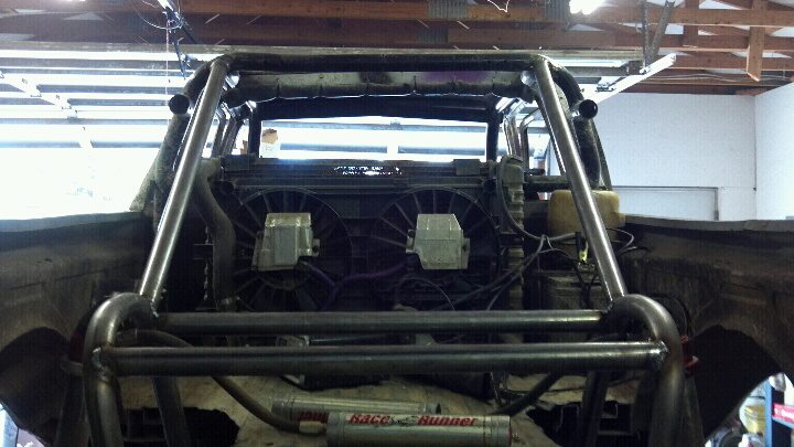

More
