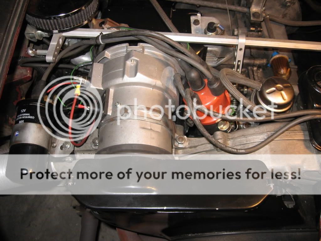

Just replaced my stock generator with a type 1 55 amp alternator and now I have plenty of power to run everything. All my lights are brighter now, amazing!
Troy helped me out big time!
Needed more power to run the new H-4 head lights and 35 watt driving lights I installed right before the Pumpkin Run.

What kind of mods were required to the engine to fit this? Sheet metal trimming? Anything else? I have seen the other style where you use an alternator from some modern import car, but they don't tell you what it is so you are screwed when it comes time to repair/replace.

Only modification was using a belt sander and sanding the housing down to fit in to the tin compartment. Didn't cut any tin.
On the other different alternators that you can use for a squareback are a RX-7 and a Metro alternators. Samba VW has a pretty good forum section on conversions.
